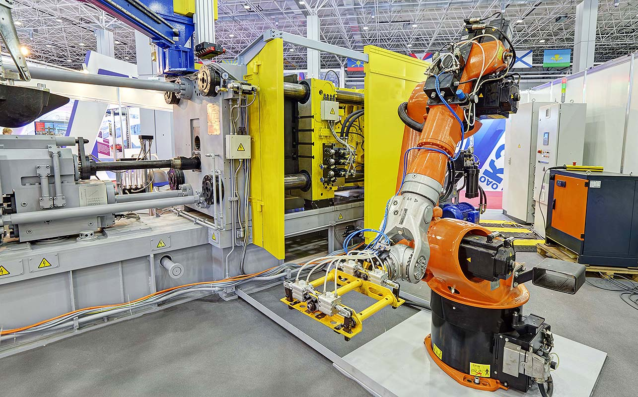

High-volume diecasting is an example of the changing operating conditions and requirements for robots in the metalcasting industry .

In the case of a Russian foundry producing castings for a European automaker, Artimpianti designed and automated two production lines of three diecasting machines, in place of a standard “Cartesian axis” installation or floor-mounted articulated robots working in a programmed sequence.
Working with ABB Robotics, a system was developed whereby a special beam supports two cantilever arms, positioned behind the workstations to manipulate the cores and the liquid metal. From the same beam, an ABB IRB6620 six-axis robot was suspended, to remove the castings from the molds and delivering them to the pre-finishing area. There, the castings cool down, sand is removed from the outer surfaces, feeders are cut, and parts are finally placed on a special multi-level cooling conveyor. Once the castings reach the correct temperature they are passed along for final finishing.
The plant layout was designed to improve operator mobility as well as safety, and to give greater visibility in the workstation where manual activity takes place and individuals may be at risk. So now, the workstation operators are able to be close to a mold for analysis, perform regular service, or change the mold without stopping the robot working in the other two work zones. The possibility of changing the mold and/or the tools without stopping the line has significantly improved Overall Equipment Efficiency (OEE) and as a result the productivity.
For this foundry, the robotic installation includes a total of 14 axes and the ABB IRC5 Robot Controller manages six axes of the robot itself, in addition to all the Cartesian axes dedicated to the molding and diecasting processes. In addition to the productivity goals, this customized installation has improved plant ergonomics and safety standards.
