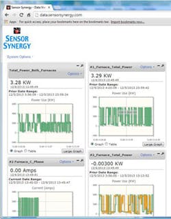

  • Features a user-friendly, browser-based dashboard accessible remotely, enabling stakeholders to view and analyze data within one minute of measurement.

The browser-based data viewer allows all remote stake-holders with an Internet connection and a web browser to view data within one minute of the measurements.

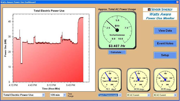

Tools within the viewer allow users to calculate total energy used for a selected time period and to compare energy-use profiles from different pieces of equipment.

Sensor Synergy’s browser-based data viewer allows all remote stake-holders with an Internet connection and a web browser to view data within one minute of the measurements. Tools within the viewer allow users to calculate total energy used for a selected time period and to compare energy-use profiles from different pieces of equipment.
Sensor Synergy’s Dashboard for in-plant staff provides data views with only one-second delay. Various tools within the Dashboard data viewer allow users to calculate total energy used for a selected time period, compare energy-use profiles from different pieces of equipment, export data files into spreadsheet compatible files, and more.
