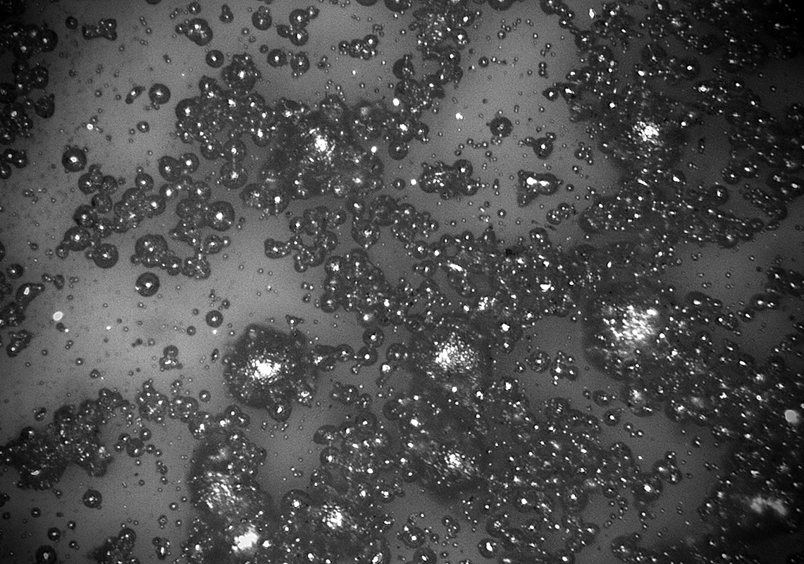

Binder-jet additive manufacturing is the process in which a printer-head device selectively deposits a liquid binder onto a layer of powdered materials (in this case, the powdered aluminum 6061) according to a pattern defined from a CAD file of the finished part. Each completed layer is bonded to a successive layer, according to the design, and the formed part is later sintered with a combination of heat and atmospheric pressure to densify the part structure.
Reportedly, Desktop Metal and Uniformity Labs, a developer of additive manufacturing materials and software, conducted a multi-year collaboration to develop a low-cost raw material that matches the workability of wrought 6061.
The developers said the new powder makes it possible to sinter unadulterated 6061 aluminum, meaning it is not necessary to coat powder particles prior to printing, nor to mix sintering aids into the powder, nor to use binders containing expensive nanoparticles or metals.
Also, the powder reportedly is compatible with water-based binders and has a higher minimum ignition energy (MIE) relative to other commercially available 6061 aluminum powders, making the binder-jetting safer.
