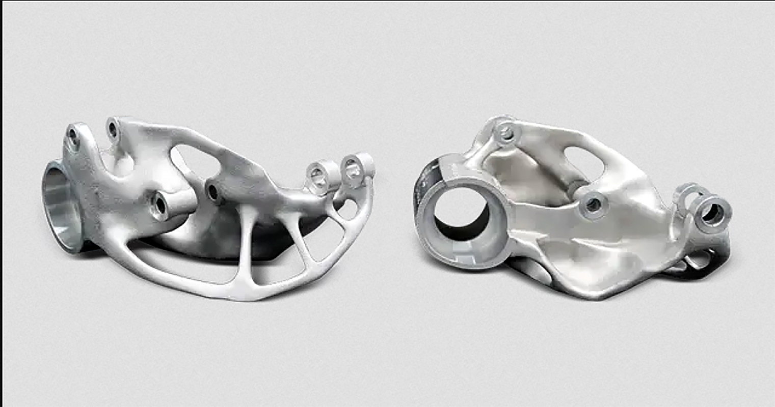

Automotive cast parts.
3D Systems
“Suspension rocker produced in Certified Scalmalloy (A) on 3D Systems DMP Flex 350 metal 3D printer. With its high strength, this aluminum material - specifically developed for metal additive manufacturing - enables customers to further reduce mass in metal structural components.”
