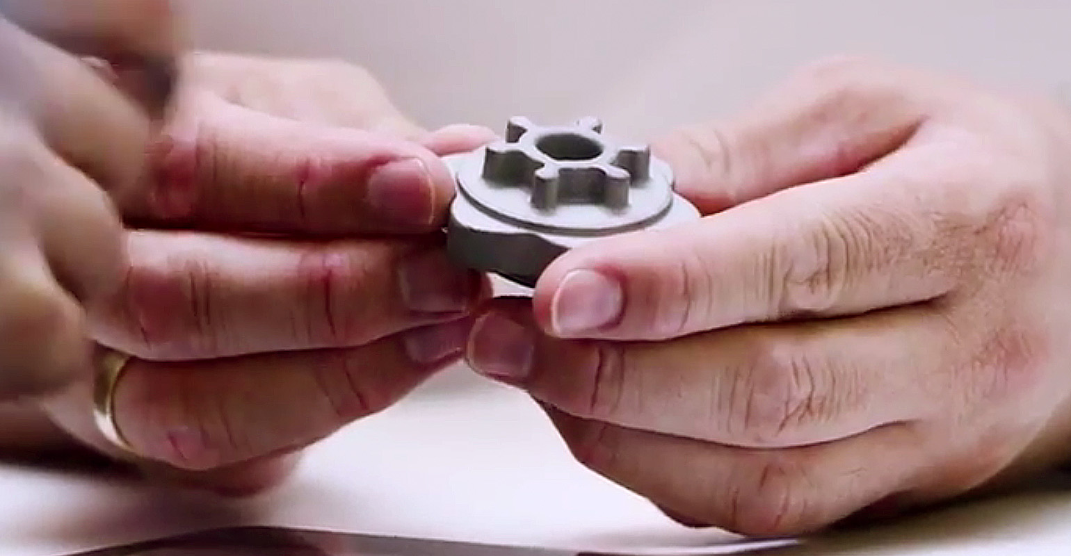

HP Metal Jet, introduced at IMTS 2018, is described as "a paradigm shift" in metal 3D printing, with greater productivity ("up to 50-fold") compared to other 3D printing methods, at nearly half the cost of other binder jetting systems. It is said to be similar to HP’s Multi Jet Fusion technology for printing plastic parts.
Working on a 430x320x200-mm bed of powdered metal, six printer heads deposit a binder according to the pattern set by the part’s CAD design. Next, an “energy source” melts successive layers of the metal into a three-dimensional part. In a subsequent step, the part is sintered into its final state.
