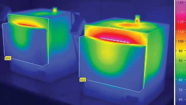

A thermograph of two IFBlined kilns shows how much heat is wasted for different lining material types during a 1000degC firing test

The thermograph image shown above shows the kilns during the 1,000°C firing test; the cast IFB lined kiln is on the left. It shows how much heat is wasted through the body of the kiln lined with the higher thermal conductivity IFB and how the surface temperature of the kiln becomes overheated. This shows both the effect of wasting energy costs and health and safety issues caused by hazardous working temperatures.
Significantly less energy was needed to run the test kiln through a 1,000°C firing cycle with the cast IFB compared to the extrusion IFB (37% less for Class 23 and 38.5% less for Class 26.) These energy usage differences are due to the differing thermal conductivities of the IFBs. In materials of similar chemistry, thermal conductivity is controlled by the structure of the material. The different manufacturing methods of the IFBs studied produce materials with inherently different macro- and microstructures and it is these that control the thermal behavior of the products. The texture of the IFBs is finest for the cast product and is coarsest for the extruded product.

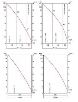

Graphs depict the results of heat flow calculations.

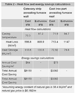

Table 2. Heat flow and energy savings calculations.
The modeling was performed using the most common, real-life IFB lining arrangements, where walls are normally built up using standard brick sizes, while roofs are constructed from special pre-assembled roof blocks.  The results are shown in the series of four graphs: The top graphs show heat flow calculations for the catenary strip annealing furnace wall using cast IFB (left) and extrusion IFB (right). The bottom shows heat flow calculations for the cast iron part annealing furnace roof using cast IFB (left) and extrusion IFB (right).
Table 2 shows the significant differences that can be achieved for casing temperatures when using different IFB types. Using cast IFB produces much lower casing temperatures than with extruded IFB. The lower surface temperature obtained using the cast IFB also produces a more comfortable working environment for operators and minimizes the risk of burns due to operators coming into contact with the surface of the installation.
The heat-flow calculations show that for the catenary strip annealing furnace wall, the lining with the extrusion IFB requires 271 W/m2 more energy to maintain the 1,200°C operating temperature than the lining with the cast IFB, due to the lower thermal conductivity of the cast compared to the extruded IFB.
The difference in energy consumption between the two simulated furnace walls equates to a saving of 42,450 m3 of natural gas per year using the cast IFB compared to the extrusion IFB. Assuming a gas price of $0.192/m3, this equates to an annual saving of $8,150/year for this wall section only. Assuming a furnace wall lining life of 10 years, the total saving over the life of the kiln lining would be $81,500.
The savings on the complete structure would be significantly larger. A 127-m2 working area in the wall of the catenary strip annealing furnace would need approximately 7,200 standard-sized IFBs. Although the cast IFB price is a little higher, the example shows an initial payback period of just over three months; for the rest of the 10-year service life there would be continuous cost savings due to the lower energy requirements.
For the cast iron part annealing furnace roof, the lining with the extrusion IFB requires 434 W/m2 more energy to maintain the 930°C operating temperature than the lining with the cast IFB.
For the 46.5 m2 working area, the difference in energy consumption between the two simulated furnace roofs equates to a saving of 17,615 m3 of natural gas per year using the cast IFB compared to the extrusion IFB, which equates to an annual saving of $3,382 per year for just this small roof section. Assuming a furnace roof lining life of 10 years, the total saving over the life of the kiln lining would be $33,820. The savings on the complete structure would be significantly higher. The 46.5 m2 roof area would need approximately 2,600 standard sized IFBs, so the payback for using cast IFB is less than 3 months.
