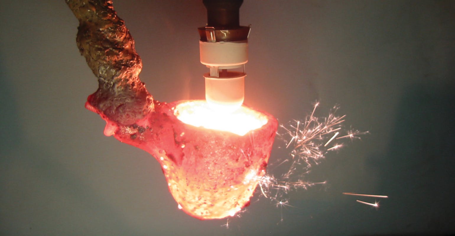

Ironcast is a former Teksid and Stellantis ferrous foundry now operating as a Cummins Inc. holding. Already a licensee of SinterCast technology, it is preparing to start casting the new engine blocks later this year. In addition to an April capacity expansion there, Ironcast has ordered an installation of SinterCast’s new desulphurization process during Q3. As described in SinterCast’s Q1 2026 CEO message this “three-station configuration” makes it possible for the foundry to treat three ladles simultaneously, for higher CGI throughput.
“This marks the first installation of the SinterCast desulphurization solution, expanding the foundry’s CGI production capability from the current induction furnaces to also include cupola iron,” according to that message.
