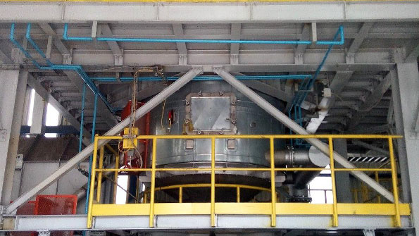

The next step is thermal treatment, with a sand regeneration furnace that operates on the principle of the fluid bed, heated by natural gas, with a calcinated sand/air heat-recovery device. Hot sand leaving the calcination furnace drops by gravity into a heat exchanger consisting of two overlapping fluid beds, where it meets a backflow of fluidization/combustion air of the furnace.
Specific valves, without moving parts and therefore suitable for high-temperature operation, allow the sand to pass from one fluid bed to the one below, forcing the combustion/fluidization air to cross the two thermal exchange fluid beds. In this way, the air is preheated before it arrives at the calcination chamber, to a temperature very close to that of the calcinated sand, greatly reducing gas consumption. For example, with a calcination temperature of 700°C, the air is preheated beyond 600°C.
Furthermore the calcinated sand definitely cools down, thus reducing the size of the final fluid bed cooler and the relative demand for cooling water circulating in its tube bundle. Again, as an example, with calcination temperature of 700°C, the sand is cooled to a temperature of about 300-350°C.
Operational safety is provided by the two pilot burners installed in the calcination chamber of the furnace, kept constantly lit and equipped with fire detector.
Gas is introduced in the furnace only when the two burners are lit, guaranteed by specific nozzles on the fluidization plate, and proper operation of the intake and fluidization of sand in the furnace have been checked.
Then, the gas and fluidization air are mixed inside the fluid bed of the calcination chamber and the flame of the pilot burners lights it and controls it over time. The thermal treatment transforms the active residual bentonite in the sand to be processed into dead and oolitic bentonite, burning all the coal and resins contained in the sand.
