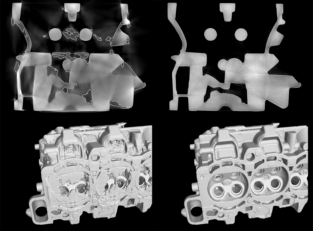

YXLON INTERNATIONAL introduced a new computed tomography system with a compact and durable design developed especially for the production environment, and specifically automotive and metalcasting operations. The Yxlon UX50 is particularly well-suited for testing components of traditional automotive drive systems, as well as the particular requirements of new e-mobility system components.
With an output of 450 kV, the UX50 is suitable for testing dense and large components and offers maximum flexibility attributed to the selectable equipment of both flat-panel and/or line detectors. Regardless of the application, extensive CT techniques and image enhancement tools ensure optimal results in three-dimensional analyses.  For example, the new ScatterFix 2.0 reduces interfering scattered radiation for particularly massive test parts in all CT techniques with the flat-panel detector and ensures optimum surface determination and high- quality CT data. UX50 also supports fast 2D DR inspections, using the proven HDR filter to provide high-contrast, detailed fluoroscopic images for accurate evaluation.
