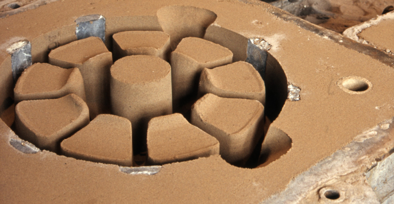

• To consider mold permeability, look at the physical properties of the sand itself and molding practices. Round-grain sands and the spherical nature of man-made ceramic media will have better mold permeability compared to similar AFS GFN sub-angular sands, like lake sands. Lower grain-fineness sands will have higher permeability than higher GFN sands. It’s not surprising that high fines (material on the 200 screen and below) will negatively affect mold permeability. Classification and dust-collection systems should keep fines below 1% during reclamation. A lower level of fines also will decrease binder demand.
Good venting practice will help mold permeability, too. Cores are vented to help prevent binder decomposition gases from being trapped in the casting. Mold venting comes in a few types: scratch vents, flow-off vents, and top-down or “prick” venting. Flow-off vents allow the air inside the mold cavity to be displaced as the mold fills with metal. However, these vents freeze off quickly which can make them inadequate for relieving binder decomposition gases.
Top-down vents are made from the strike-off surface of the cope or drag but stop within 1-2 inches of the casting face. As the binder decomposes, these “air gaps” will give a shorter and easier path for the gas to escape the mold. As long as mold-handling strength is not compromised, a mold cannot have too many top-down vents.
