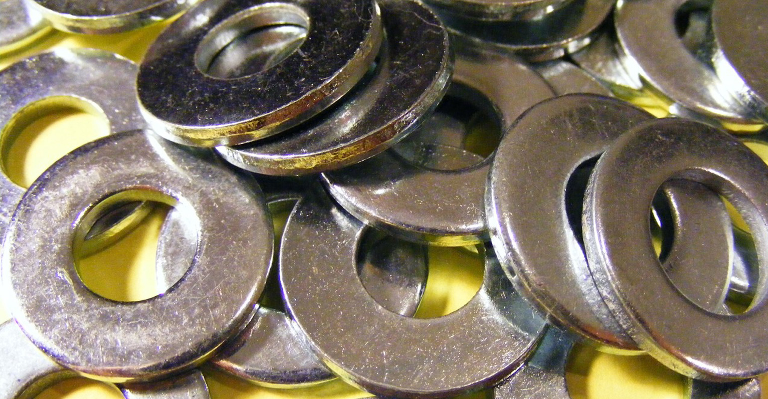

There are two finish-machining processes for handling high volumes of metal parts. What’s the difference, and what are the decisive factors for an operator choosing between them?
Vibratory machines and barrel tumblers are both mass finishing technologies that render a refined finish to massive volumes of parts in a short span of time. Both methods are capable of preparing metal parts for coating, and both are widely used for polishing, deburring, burnishing, de-scaling, de-flashing, and radiusing. However, there are several differences between these two equipment choices in terms of operating processes, uses, media, and so on.
What is vibratory finishing? — Vibratory finishing involves placing parts, media, and compounds into a vibratory tub or bowl. This machinery then applies force to the parts, an action that leads to the media and the parts to rub and grind against each other, the effect of which is to deburr or polish the parts.
This type of finishing also is widely used for mass finishing applications such as cleaning, descaling, polishing, and surface preparation. The results of this type of deburring cannot be achieved with manual labor, which is why vibratory equipment configurations such as batch tubs, round bowls, or through-feed machines are selected by high-volume manufacturers.
What is barrel finishing? — Barrel or tumble finishing involves placing parts, abrasive media, and the compounds in a barrel with water. The rotation of the barrel leads to the tumbling of the media mass and parts. This causes friction, which results in the abrading of the parts in the mass, and the quick and efficient deburring of the part’s surfaces.
Typically, deburring barrels come in the form of batch-type processing machines. However, in-line batch processing and single-pass processing equipment also can be found.
The difference between barrel tumbling and vibratory finishing lies in the way that the machines create the necessary degree of friction between the parts and media that is required to eliminate imperfections from those metal parts.
