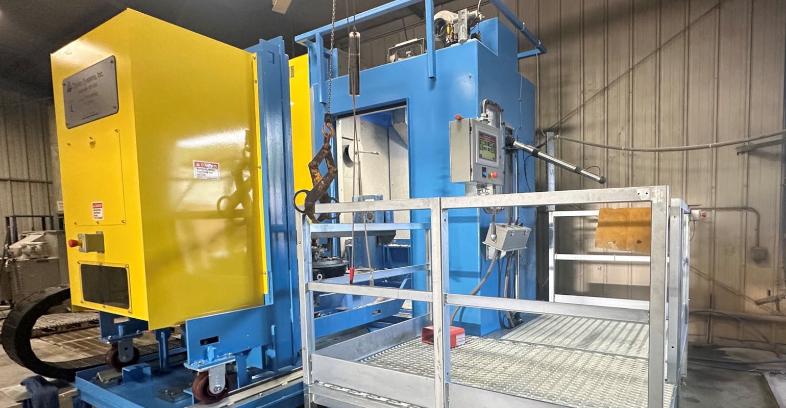

Franklin Precision Castings, the Pennsylvania investment caster, reports it purchased and installed  20,000-PSI water-blasting system for removing ceramic shells from cast parts. The Model TRX-1250CAM  system supplied by Triplex Systems Inc. offers both automatic and manual operation, and is said to be a safer and more efficient way to remove the shells, accelerating the production process.
The TRX-1250CAM operations combines automatic and manual cleaning cycles in a single cabinet. This technology allows operators to switch between operating modes seamlessly via a user-friendly touchscreen interface, all powered by a high-pressure pump unit.
A built-in drag conveyor unloads broken ceramic shell into a hopper, easing the risk of back injuries and enhancing operators’ safety.
“The Triplex water blasting system has reduced our cycle times by 50 to 75%, a remarkable improvement,” stated Mark Johnson, cleaning room supervisor at Franklin Precision Castings.
