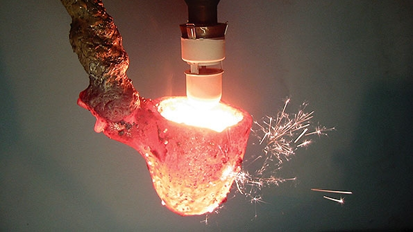

Dongfeng Commercial Vehicle Co. Ltd. plans to install a SinterCast Mini-System 3000 will be installed at the Dongfeng Technology Centre's R&D foundry located at Shiyan City. The system will be delivered during Q1 2015 and installed in Q2, in preparation for Dongfeng’s development of cylinder blocks and heads in compacted graphite iron.
Stockholm-based SinterCast is the world’s largest supplier of process control technology for producing CGI, a lightweight alternative to gray iron and aluminum for automotive component manufacturing.
System 3000 is the third generation of SinterCast’s process control system, for use with foundries that produce CGI in pressurized pouring furnaces or by ladle pouring. The Mini-System 3000 parallels the technology for research and product development programs.
In addition to supplying the system, SinterCast will provide technical support as Dongfeng establishes CGI production procedures and CGI product development.
