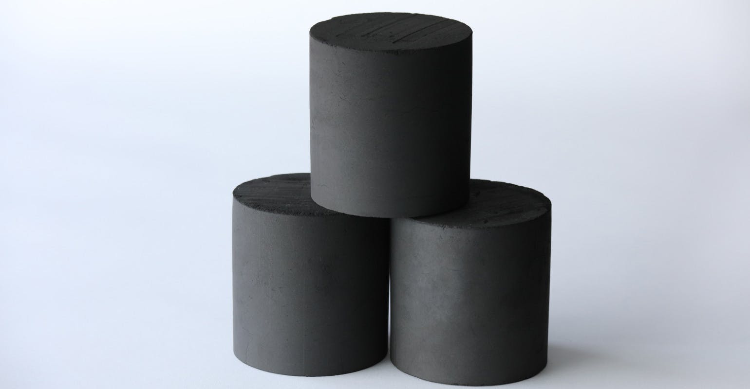

Bio-coal briquettes derived from coconut shells.

Mazda Motor Corp. reports it conducted cupola melting tests at its Hiroshima, Japan, ferrous foundry in which CO2-emitting fossil fuels were replaced with “biomass fuel” – meaning organic matter that can be burned to generate heat or converted into liquid or gas to generate energy. Specifically, Mazda fueled its cupola with bio-coal briquettes derived from coconut shells.
