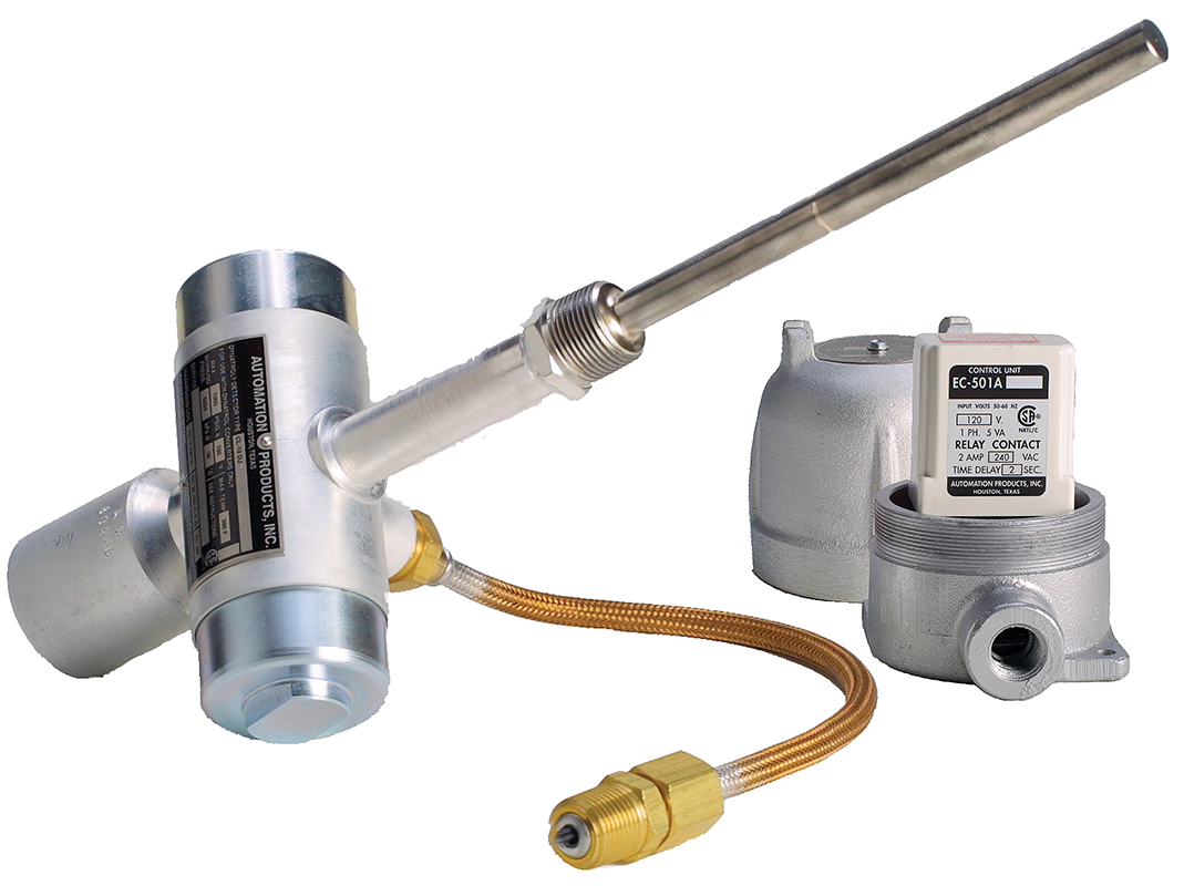

AUTOMATION PRODUCTS INC. Dynatrol® DJ level switches are designed for application to either high- or low-point level detection of bulk solids, in particular abrasive materials.  The rugged design and vibrating probe prevent build-up and ensures the most reliable level measurement.  It can be used in bins or tanks for problem applications that include dust collection, sand, gravel, rock, crushed stone, ore, talc mine, crushed dolomite and recycled crushed concrete, as well as lightweight aggregates: clay, pumice, perlite, vermiculite, etc.
Reliable operation can be achieved with this control. This level switch is approved for Class III services, as well as for Class I, Groups C & D; Class II, Groups E, F & G; Class III approved.
Installation is simple, according to the developer. The level switch is mounted through a ¾-in. half-coupling at the point of desired level detection.
Dynatrol® switches are constructed for long operating life, require no adjustments and have no moving parts.
