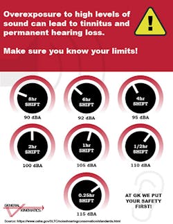

The permissible exposure limit (PEL) regulated by The United States Department of Labor is dependent upon the hours of exposure to noise. If working an 8-hour shift the PEL for that time is 90 dBA. The dBA PEL continues to gradually increase as the time spent exposed to noise decreases.
The permissible exposure limit (PEL) for noise
in the workplace, regulated by the U.S.
Department of Labor, depends upon the hours
of exposure to noise. If working an eight-hour
shift, the PEL is 90 dBA. The dBA PEL continues
to increase gradually as the time spent exposed
to noise decreases.

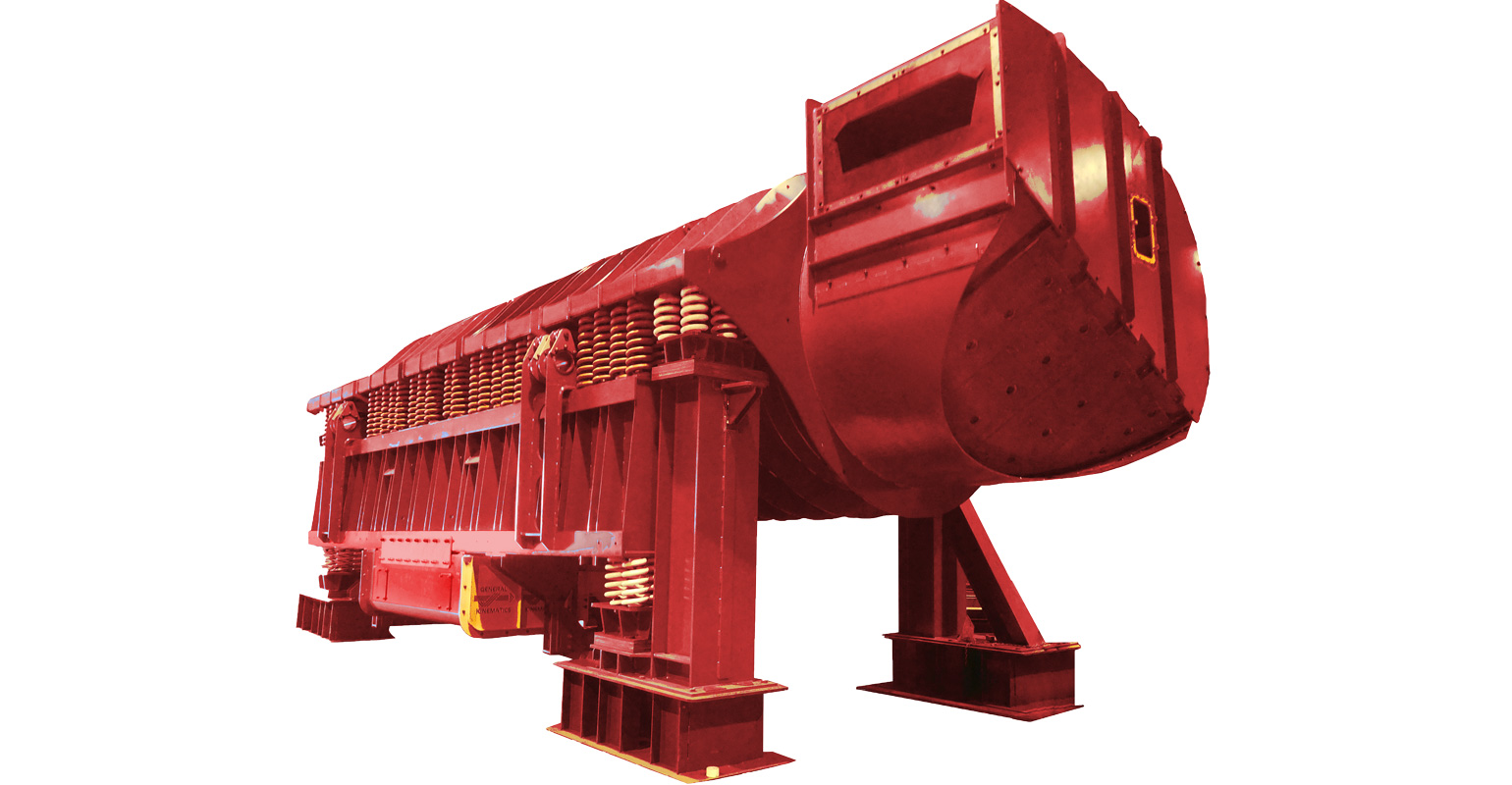

• Automation with the GK Vibra-Drum® Casting Conditioner. This drum effectively cools and conditions sand and castings before they come in contact with people.
